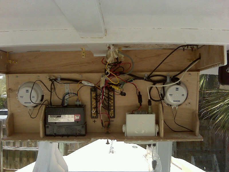

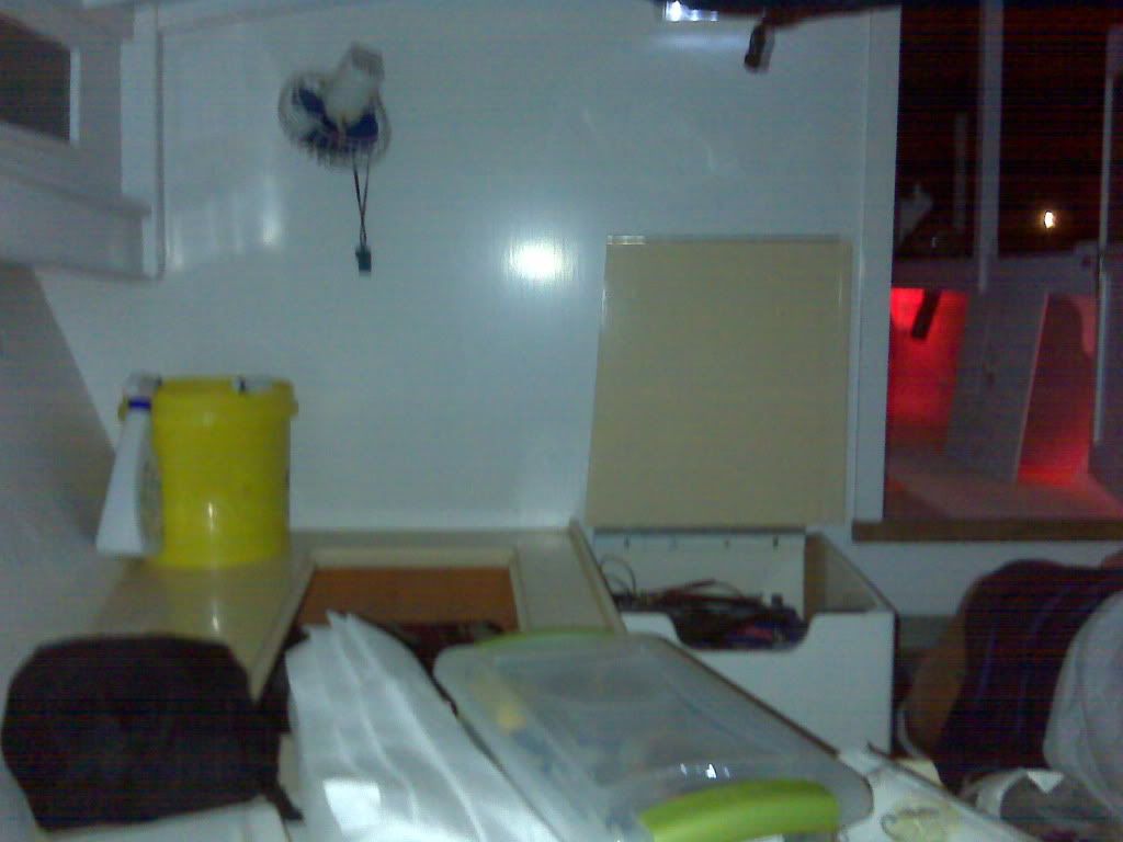

More up dates,
I slacked off on finishing the engine box however it is now primed and ready for paint this week. In the mean time I have spent some time rewiring the boat and removed the old consol. I found a lot of older boats have most of the gauges and controls mounted directly to the bulk head. This also gives more room in the cockpit where you spend all you time anyway. I will be building a box to cover the wiring inside of the cabin eventually.

Next project is painting the rest of the boat. What is the best way to remove paint form a boat? All of the decks and floor have nonskid and the hull paint is peeling to the next layer of old paint. Should I use marine paint remover? Pressure washer? Sand it down or all three? Just like most people my time is very limited to work on the boat usually nights. So what is the best method? Pros and cons?
I was leaning toward the paint remover, sanding, filling and starting the paint process.
Thanks
Jamie
