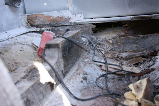

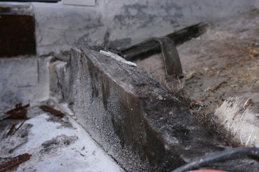

Pulled the engine this fall to paint the bilge and to replace a worn out outer transom plate. Upon pulling the plate found the transom was rotted and soft. Which lead to water logged stringers,bulkheads and foam. What is the best the best biaxle cloth to use to tie the trnasom and stringes back into the hull? I will be using epoxy . Also my stringers were made out of a solid peice of wood. 2.5 inches thick, 36 inches long and 7.5 inches wide (at it's widest part) I'm thinking of just epoxing and screwing 2 peices of 2x8's together. Marine epoxy what is the lowest temp u can work with? I know west is good till around 40 deg. I will be doing this project during the winter. I have a tarp over the boat and with a portable heater can problem get the air temp up to around 50 deg or so. I think that's about it for now.

For my 21 footer, Joel recommended 3 layers 12 oz biax tape for tabbing the sides and 3 layers of 1708 45/45 cloth capping the stringer. You boat is bigger, maybe Shine will recommend adding a layer.
Was the engine bolted to these stringers? If yes, you'll want hardwood to replace in kind, if not, build up a similar width by epoxy gluing marine ply to get the same thickness.

Yes the engine mounts to the stringers 4 lag bolts. I was thinking of using plywood but i don't think plywood would hold lag bolts very well. For me i can work in a t-shirt till around 40 deg. In the northeast are boating season is short so i didn't want to spend next spring and summer on this project. I'd rather do it over the winter when i'm not sweating my butt off.lol

Marinepoxy is good at 45 degrees then it shuts down until it gets above that temp again and then goes on curing. Just allow a little more time for it to cure at the lower temps.

Is there any way to change those lag bolts to through bolts with nuts? If you can do that, you'll be able to overdrill the holes and fill them with epoxy/wood flour putty and redrill to the finished size. :?:

I was thinking of drilling the motor mount holes then installing ss bolts epoxied in the hole. I assume if using plywood for new stringers i should use 3/4 inch and have the plywood running vertical?

gk108 wrote:Is there any way to change those lag bolts to through bolts with nuts? If you can do that, you'll be able to overdrill the holes and fill them with epoxy/wood flour putty and redrill to the finished size. :?:
GK, I was wondering the samething but in the gallery I see the motor mounts sitting on top of the stringer and lag bolted down into the wood. First thought was to laminate in some T-nuts and bolt through but getting those holes lined up perfectly would be darn near impossible for me. :help: Lime may be a more high precission kind of guy. What do you think about going ahead with the over-drill/fill approach but then using S/S lag bolts? Maybe if we bat this around a little we can come up with the "ideal" solution in this type of application.
Just had a thought (I get dangerous when I think :doh: ), why not pick up some 3 or 4 inch heavy guage aluminum angle stock and make a couple of brackets? Bolt the motor mount to the aluminum, notch out the top of the stinger so the bracket is flush with the top of the stringer (and seal it, of course) then through-bolt the brackets to the stingers? :D

Well if i wanted to the ideal thing to do is to reinstall the engine after the stringers are in then mark where the motor mounts go then remove the engine and drill out the holes. The alum sounds like an idea. Just have to watch my height. The string is around 7 inches high then there was 1/4 inch of glass over the stringers as well.

Is the transom rebuilt? If not, that should be finished before you go after the stringers.
For the stringer; you can laminate two pieces of lumber, not problem, but you must use a clear straight piece of wood. I would use fir, actually, I would use multiple layers of 3/4" plywood :)
hardeners: 40-50 degrees means fast hardener and even that will be slow (which is good for big lamination jobs)
I need more information before I comment on a lamination schedule. Need to know:
thickness and spacing of all internal structures: stringers/frames/sole
thickness of old transom (skin and wood core)
is this an I/O drive?
Some pictures from a wider view would also be helpful.
