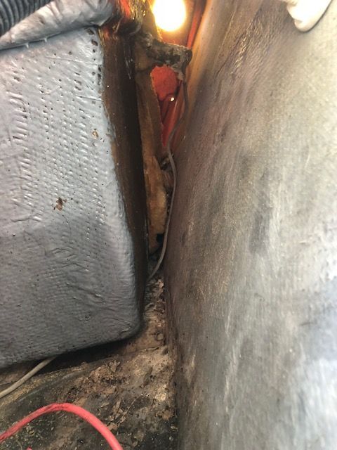

After some further investigation looking inside from the now battery box and sanding some areas to see if i could find a seam of fiberglass it is all one piece. Looking down the inside there wasn't anything i could see that is holding the cap and sides down, i believe where the floor starts must be epoxied to the stringers or something similar cause those spots seem to be more sturdy. If so when cutting what would be the best bet to be able to glass the cap and sites back to the floor? Picture below.

I have a few general comments.
First, make sure you know what the hull is made of before you progress at all.
If the hull has a core, like balsa core, you want to make sure the core is not rotten. A rotten core in a boat such as this renders the project nearly useless, imo.
Second, before cutting away the sole/floor, take a few pictures of it and submit them here.
Oftentimes, leaving a portion of the sole intact on the edges will make repairs easier. Sometimes the sole is tabbed into the sides and if so, leaving a small piece of the old sole will provide a place to make a tab for the repair. Removing it fully makes it a pita to fix.
Otherwise, submit a lot of pictures to the forum; it'll pay off.

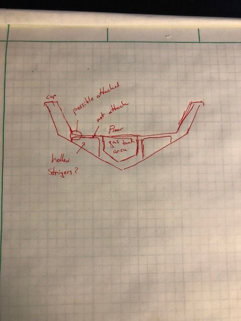

Im going to try and give dolphin a call today to see if they can lend some advice at all. From the picture where all the wires come through the hull. i probed around in there. One thing i found is all the plywood is gone, as if that wasnt a given, but what seems to be supporting the deck or what it sits on seem to be 2 huge stringers or a false floor on either side of the gas tank compartment. Seems as if there is some foam in there but not filled all the way up. They are made with heavy duty fiberglass. Heres a cross section of what it looks like. You can also look back at the other picture that looks on the inside running down the sides. You can see that the cap/mold floor sits on these. The floor is not directly attach to these for the majority, but seems like they are attached on the outer edges.

Post by fallguy1000 » Thu Jun 07, 2018 3:35 pm
A lot of times the sides meet the sole and no stringer under. If so, leaving a tab or the tab of sole about an inch allows for you to glue a tab under, but if you have a stringer there; no need.
