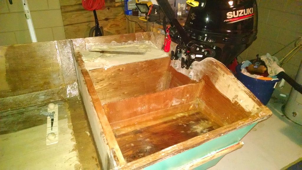

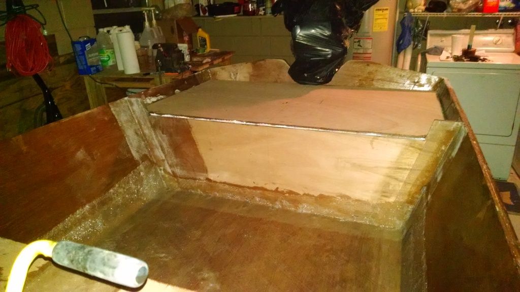

Foamed the rear compartments last night. On the left side I foamed about 1/2 of it then glassed a piece of 3/8" ply to create a small storage bin. It's angled towards the center of the boat for drainage. Before I put the foam on the right side I put in a picture of my previous FL14, it was tough to sell the other one and I learned a lot that helped on this project so it felt like a fitting tribute.

Keep an eye on that left compartment, the foam continues to expand for a while after the initial push, so it may be putting pressure on the new ply you glassed in. Then again, it's not that big of a compartment so you may be fine. :D

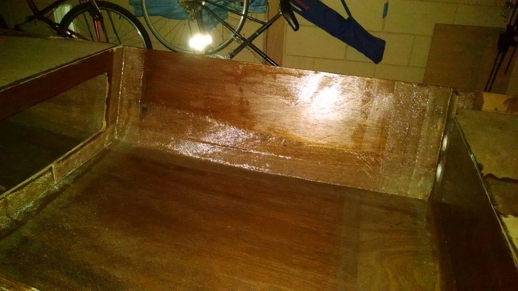

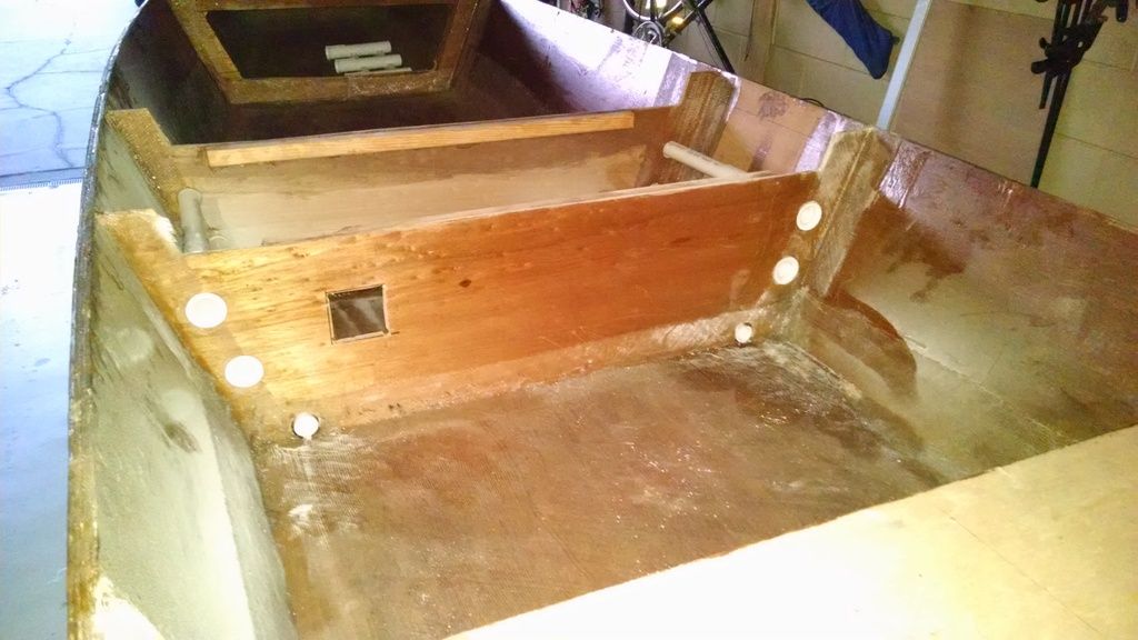

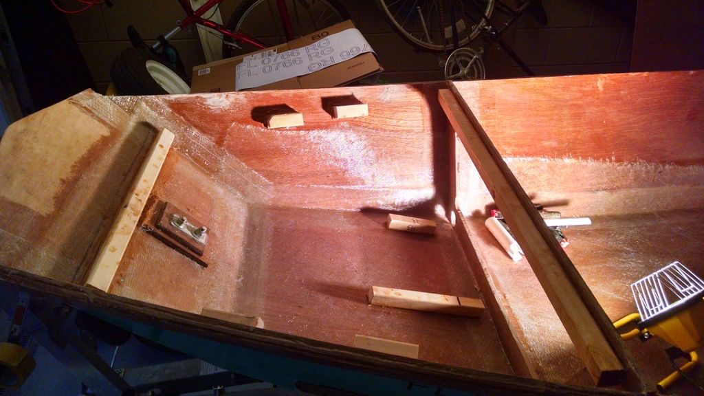

Working little by little but the goal is to get a small job done each night. Wide glass over the rear and front decks, pigment added to the inside of the rear seat storage compartment, electrical panel cut out and center drain tubes installed. I originally had ripped a piece of 1.5" PVC in half for the drain tubes but I didn't like how it turned out so I ended up with a full diameter piece instead. I had already epoxied the half tubes in then realized I didn't like them so I changed it on the fly. Luckily it's still winter so the epoxy hadn't set up yet.
94'325is
Posts: 274
Joined: Tue Dec 17, 2013 8:46 am
Location: Florida
Re: GF16 in FL
Post by 94'325is » Thu Feb 09, 2017 8:25 am

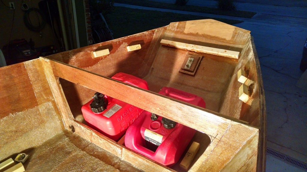

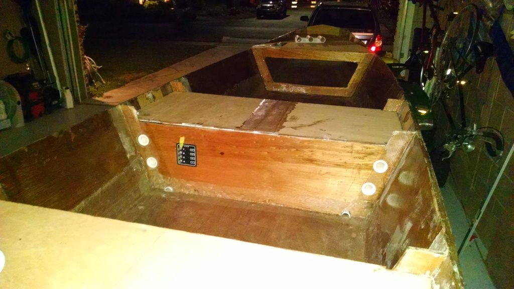

Lots of smaller details taken care of: electrical wiring done (removed for later permanent installation), center drain tubes installed (ripped out the 1/2 diameter sections since they were causing problems), rear seat mounted permanently, bow deck supports in place, fuel tank mounts in, and a few other smaller jobs.

Post by Rollbar » Thu Feb 09, 2017 9:02 am
Question, did you check for the location of the fuel pick-up in those tanks if in fact you will be mounting them in that position/orientation? Just a thought that came to me as I was reading you post.
94'325is
Posts: 274
Location: Florida
Re: GF16 in FL
Post by 94'325is » Thu Feb 09, 2017 9:17 am
Excellent question and yes I did, I would have preferred them to be in a different orientation but this was the best way to mount them.
