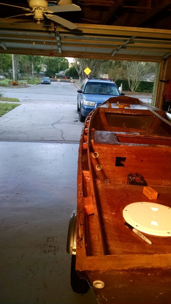

Got the left side inwale installed and dry fit the right side. I used 1"x2" douglas fir cut to 3" long pieces and a 2" x 0.5" piece of teak. I epoxied the doug fir pieces to the inside of the hull and screwed the teak to them. I countersunk the screw heads so there's nothing sticking out to catch line on.
Still some trimming to do but there's a lot of sanding/cleanup that needs to be done all over the boat.

Post by 94'325is » Mon Feb 20, 2017 8:12 am
Lots of grinding and sanding this weekend, lots of fun but it was worth it. I ground down the rubrail all around getting rid of different heights and sharp spots. Ground the spray rails down as well to get them cleaned up. I coated everything with epoxy and will be varnishing later on. The inwales are mounted as well as the bow/stern cleats and pre-made rod holder. Goal is to get the boat ready for primer this weekend.
Also cut the bow down, in my opinion it looks better flush than with a raised peak.

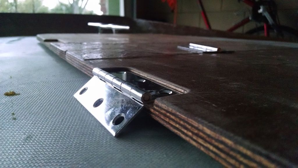

I recessed the hinges into the hatch and surrounding seat top, will then through bolt the hinges, cut a relief slot under the hatch lip for the hinge mounting bolts on the hatch then start working on gutters. The plan is to not make it watertight but at least hopefully water resistant.

Post by 94'325is » Fri Feb 24, 2017 10:06 am
Worked on the center hatch and gutters last night. There is a lot of trimming and sanding left to do but I'm happy so far with how it's looking. The flash really brings out a lot of ugliness but it's still a work in progress.
