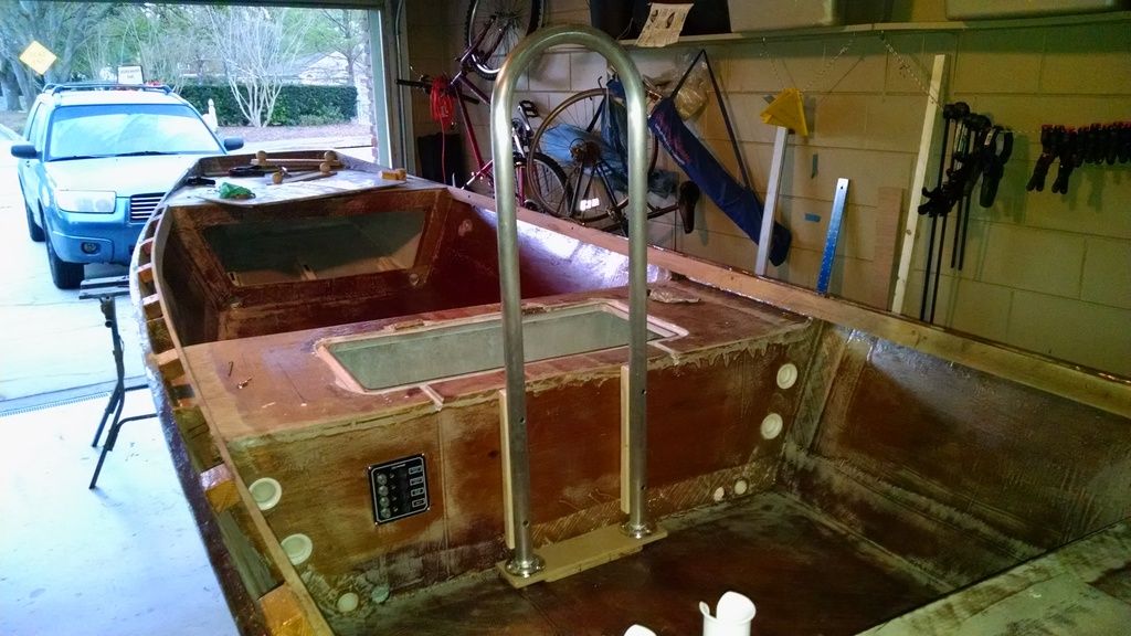

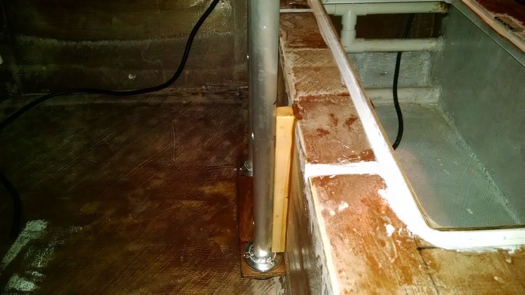

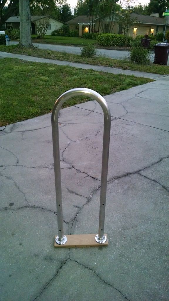

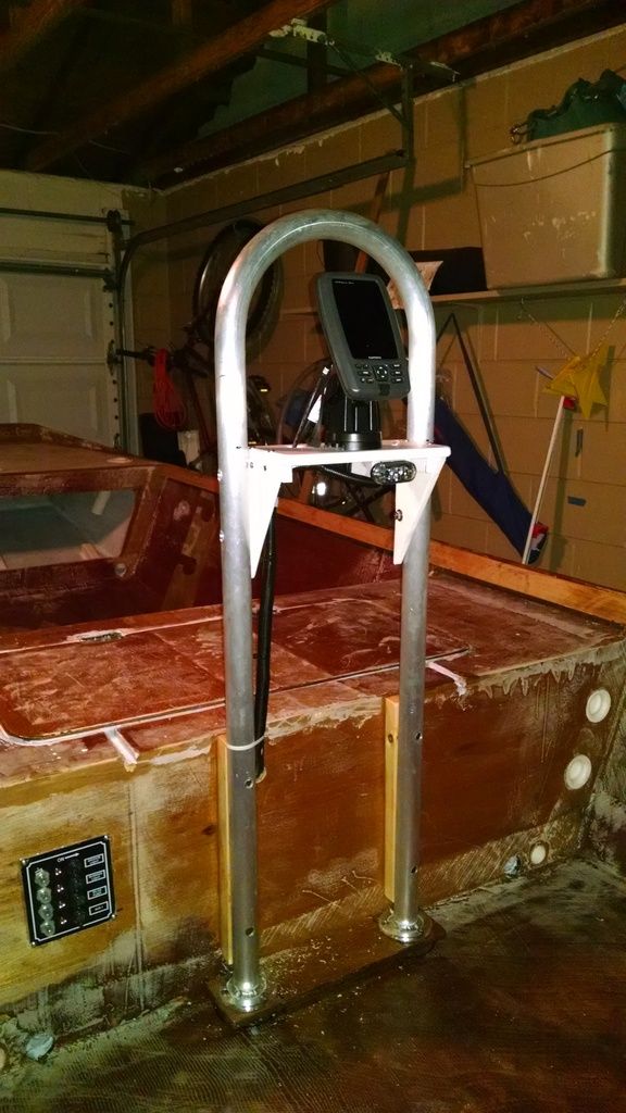

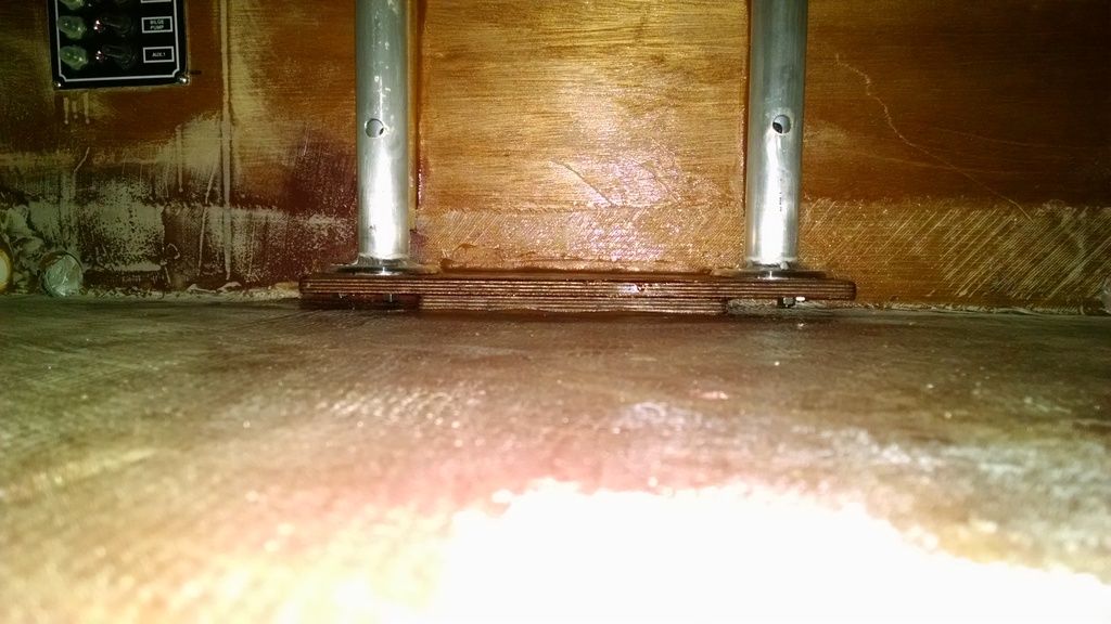

Bought a grab bar and got it ready to be mounted. Nothing is epoxied yet but everything is cut/drilled so that will be tonight's project. Since the boat doesn't have a true deck/bilge setup bolting to the hull was out so I had to come up with a mount that would allow for through bolting to the bottom as well as open base to allow water to drain. It will also be bolted to the rear of the center seat.
The next plan is to fabricate a shelf for the GPS and to run the wires internally through the seat to the bar so there's nothing exposed. It's getting there slowly and I have to keep reminding myself that there is no deadline on the boat so taking my time to get it right now will be for the best in the end.

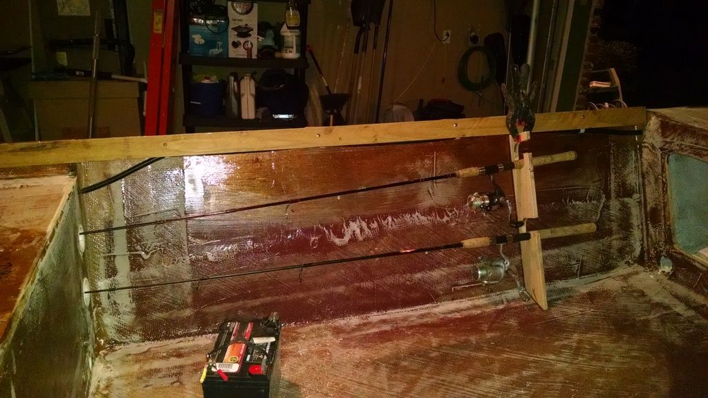

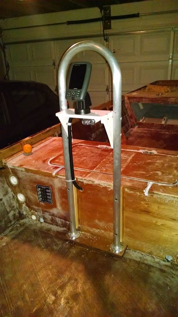

I got the grab rail mounted and secured, it's very solid. I've already used it a few times moving around the boat and I can definitively say if you are falling it is nice to have. I cut out the rod holders and have them mocked in place. The upper rod is higher than the lower to allow for clearance for larger reels.

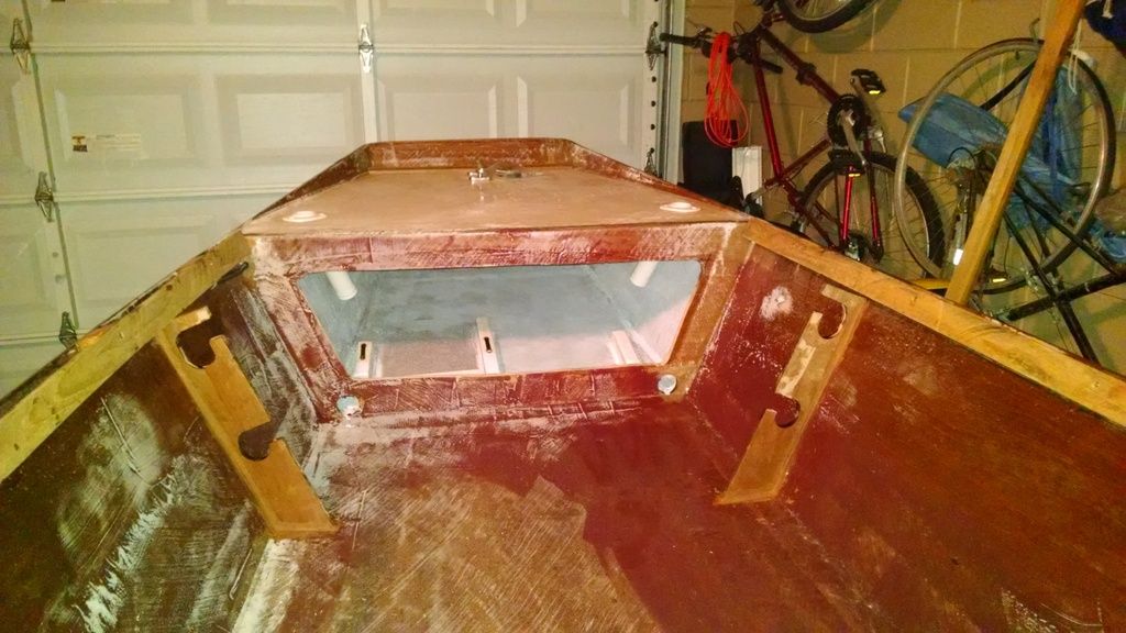

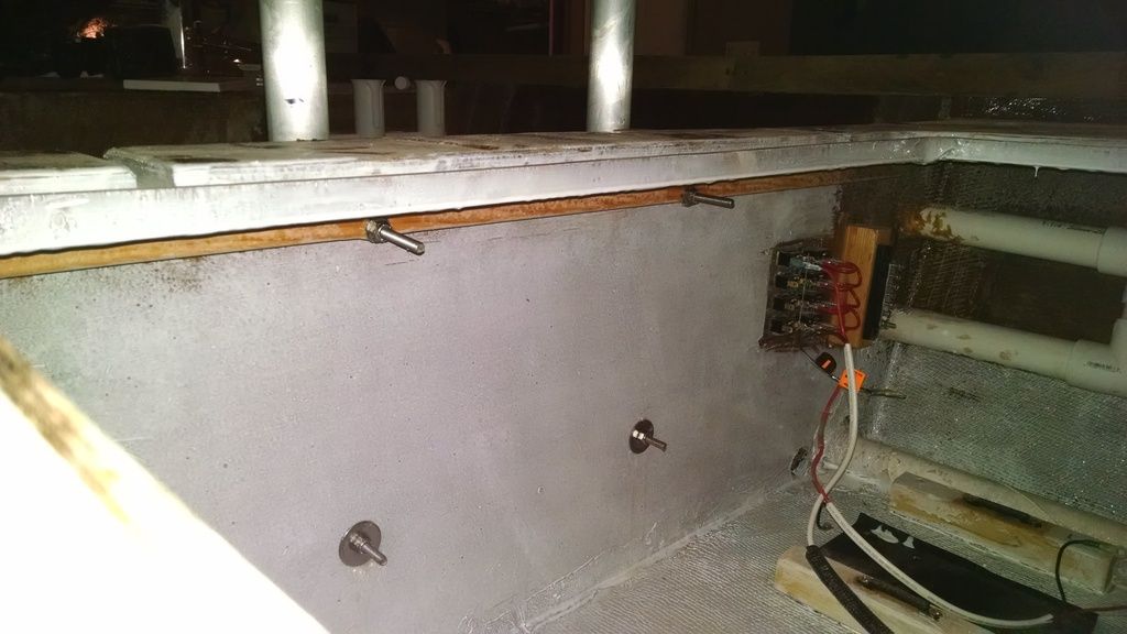

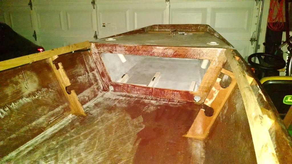

I epoxied the horizontal rod mounts in place and mounted the 'trolling' rod holders in the bow. I am going to cut down the tube so it doesn't extend as far into the bow compartment and throw a bolt through it so that the reel doesn't bottom out on the deck in the holder.

Built and mounted a shelf for the GPS and LED deck lights. I told my wife around 7pm that I had about 30 min of work left, next time I checked my phone it was midnight but the wiring is all done and everything works great. I'm planning on building a small clear plastic windshield to mount in front of the GPS so I don't have to take it off when towing. The picture with the lights on is no other light in the garage on but LEDs look weird in pictures. Getting closer!

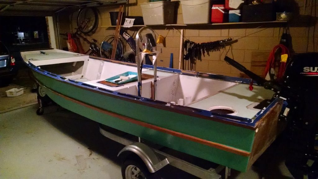

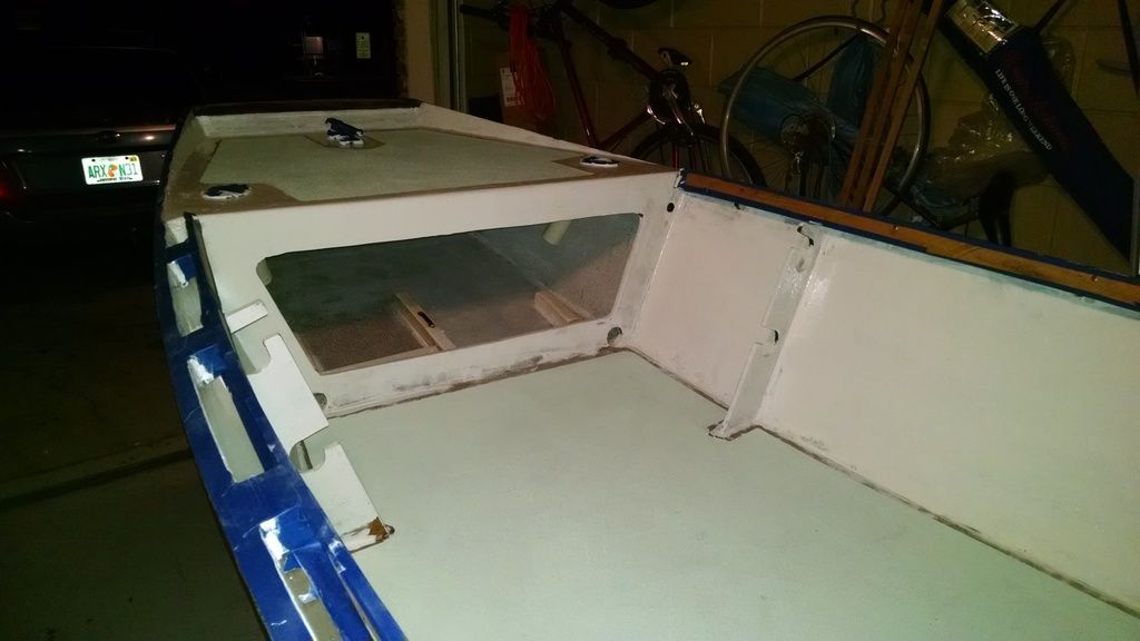

Getting very close, took tomorrow off for a hopeful launch. The varnish won't be done but I'm at the point where I want to see it in the water and it's killing me seeing it this close.
I primed the interior and got the Kiwigrip down. I ordered white KG and wanted to get it tinted but none of the places around me would tint. The best offer was from Lowes to give me a spraypaint cap of their standard water based tint and do it at home. I ended up with a light green (which is what I wanted) in order to have some contrast with the white on the sides and to follow the theme of the seafoam green exterior.
Sorry about the bad lighting, I've been working until midnight everynight trying to finish.
