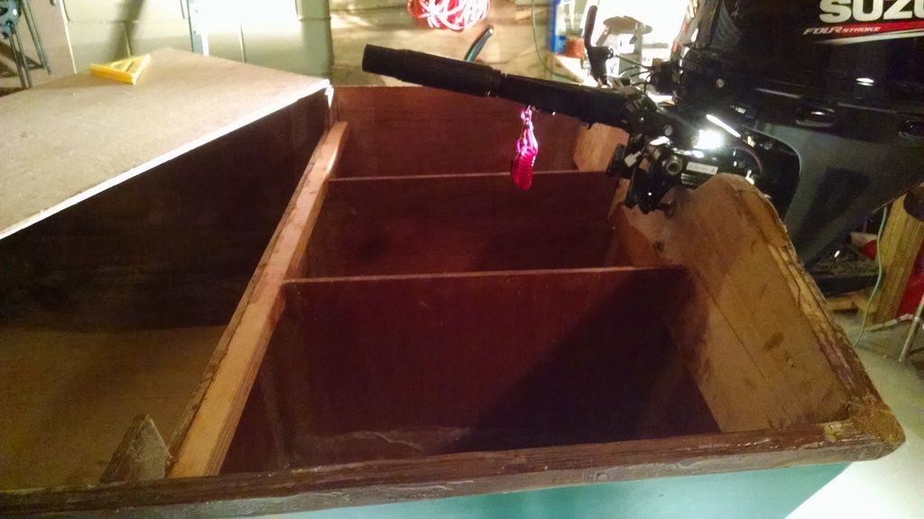

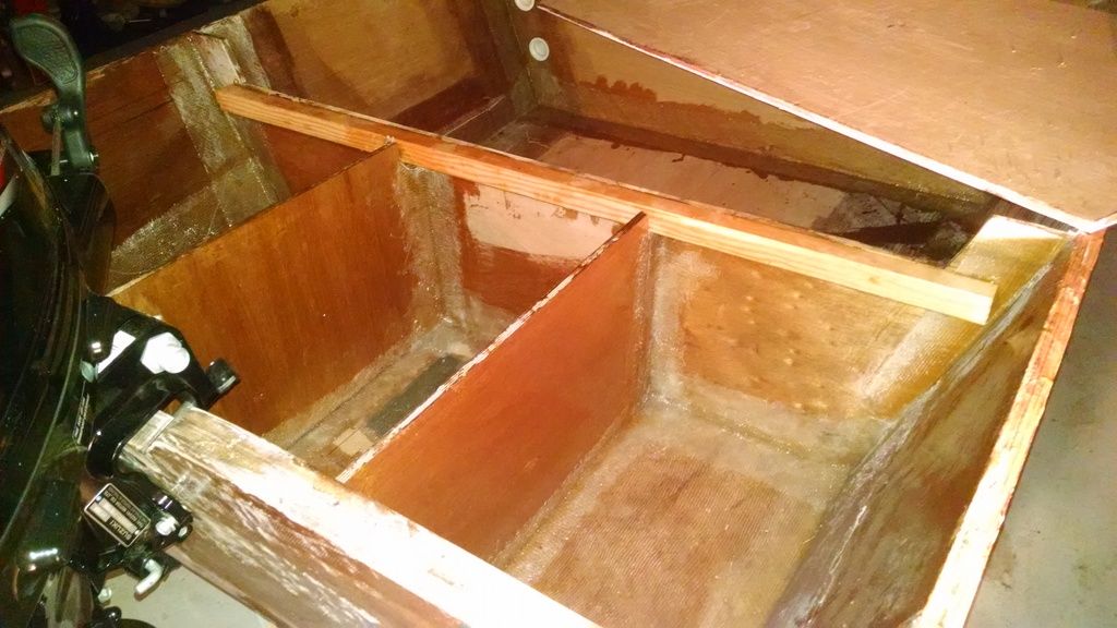

Got the transom bulkeads cut and glassed into place, used leftover 1/2" ply. The plans don't call for them but it serves me 2 purposes; 1. stiffen the transom even more and 2. give me extra storage. I'm planning on filling the outside compartments with foam and the middle will be open to allow for water to drain. I have 2 gallons of pourable foam so what that doesn't fill all the way I'll make a shallow storage compartment for tools/smaller items.
