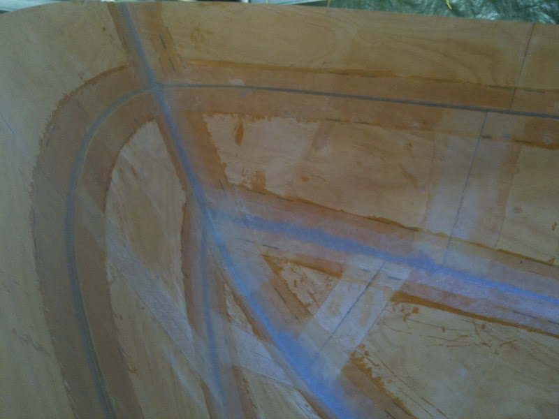

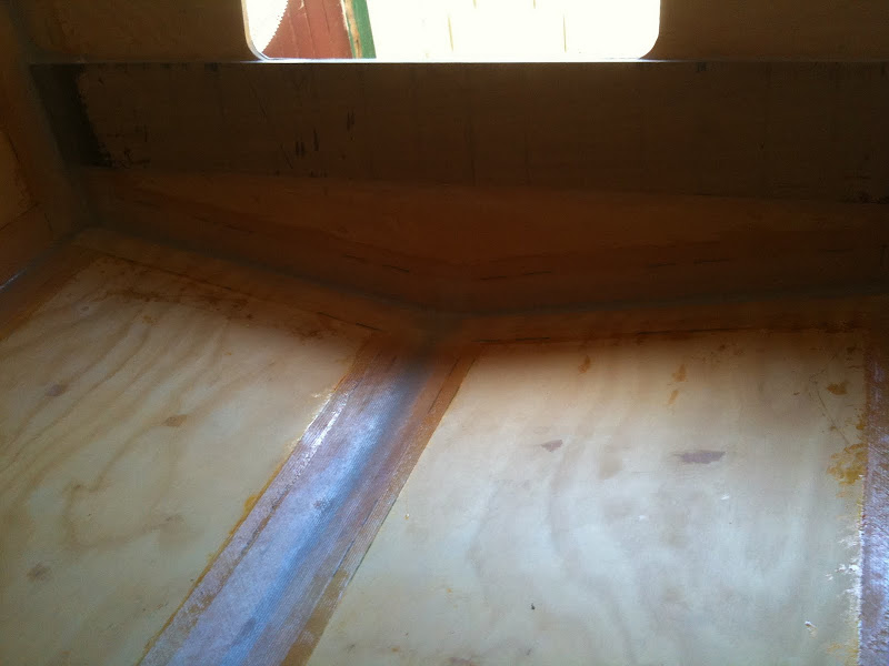

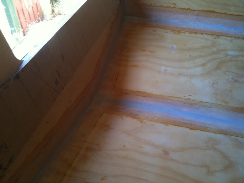

The keel, bow and transom have now been taped. I made a better roller for the wet out board which made the job twice as fast. I now need to prepare the cloth for the inside of the hull. I am pleased with how the taping turned out. Preparation was the key, by the time the tape was rolled out it, it was just getting warm on the roller. The new green gloves made a big difference over the cheap white latex ones I was using before.
Some more photos;
The keel.
The bow.
The transom.
Marking the tape lines definitely minimised wasting epoxy.

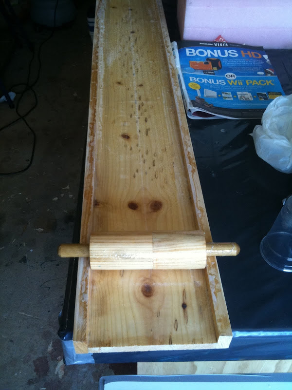

The new roller.

Do you find the roller wets out the tape faster and better than a squeegee in your wet out box??
Did you make the roller?
Do you wet out the whole length of tape for those long runs or do you lay it in short pieces.
Would appreciate your response to the above, I am building the GT27 and will be taping lengths up to 6-7 metres :help: so any advice to speed the job up would be great.
The roller is just to roll up the tape after it has been saturated with epoxy, I use a brush with bristles cut in half to shorten and stiffened it. I put a plastic sheet on the wet out board for each new length of tape.
Yes out of two pine blocks, drilled a hole right through for the broomstick, two blocks so the drill bit would go the whole length ~6". Between tapes it gets a little tacky, so I smear a little epoxy on the broom stick to keep slippery.
I do the whole length in one hit. I weigh the cloth tape and mix an equal weight of epoxy in an icecream container. Takes me about 45min do each 6m length from starting mixing to beginning the next one.

you don't need a wetoutbox like that
Using a wetoutbox makes the job far easier and quicker in my case. I waste less, no drips and I know it will be close to 50/50 ratio and have hardly any air bubbles trapped, and it is applied evenly. Also in 35C plus heat, the epoxy goes off really quick, so I can not mix the whole amount of epoxy needed for the 6m length and then try and wet it on the boat. Plus it is far more comfortable standing up doing it a bench and taking it over the boat and rolling it and patting down with gloves and then use a roller. The other problem I have is dripping sweat everywhere in the boat, especially out of the gloves.
