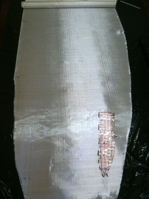

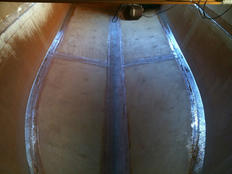

Hi again,
This weekend I began the cloth on the inside of the hull. I managed to do the side panels and will have to do the bottom panels next weekend, I ran out of time. It was a long day. I mixed small pots and and applied all day Saturday and then this morning I filled the weave and made sure where the overlap is for the bottom cloth I will enough resin over the cloth to lightly sand. I am pleased with the progress, but the bottom panels will be a challenge :doh:
Some pictures of the panels.
