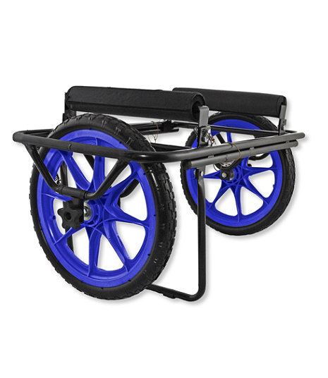

terrulian
Posts: 2349
Joined: Sat Dec 07, 2013 11:29 am
Location: Marin County, CA
Re: Jaysen's V12 -- 'Lil Bit' of everything fun
Post by terrulian » Tue Sep 19, 2017 10:19 am
Jaysen,
Don't invest in one of those over-priced dollies until you get a further report from me. I use this: Image
But what I have added is a brace between the two frame crossmembers made of 2x6's with a recess. It holds an eight-foot 1-1/2" aluminum pole for a tongue, by clamping the boards together with two bolts and wing nuts, which are easily removed. The result accomplishes the same thing as the cart you're considering, at about 1/3 the price. I haven't worked out the details but have launched it once using this method and it needs a longer pole so I'm thinking I will add a PVC extension. As you understand, without the extended tongue, the cart will not be recoverable on a ramp. This cart can handle reasonably firm beach sand and pretty large surface ruts and rocks.
Tony
Jaysen
Posts: 3161
Joined: Wed Aug 05, 2015 7:59 am
Location: St Helena Island, SC
Post by Jaysen » Tue Sep 19, 2017 10:35 am
I've really tried to avoid the Dynamic's solution. Thing is there are a number of things I can't "make" easily on my own that are key to me at this point
1. Lower COG when on the cart. Due to the steep incline of the ramp I need the hull as low as possible to ease getting her up and down.
2. Dang wide tires. It's the mud that's killing me. We've got that high organic stuff that sucks things down. The 8" wide should allow me to launch at lower tide as well as recover to safety in the marshes should I get caught out in a bad storm.
3. Hitch. I'm going to be dragging her about a mile here in CHS. Gulf cart access makes a solid hitch very desirable.
4. Strap vs bunks. While I like the idea of the bunks, the reality as I've seen it is that a strap will make quick recovery much simpler. add the lower COG and loading from the side is much simpler too.
5. Flat storage in the boat to take it with me. Other than the obscene wheels this thing collapses small enough to fit in the boat will full fishing load. That's a big thing as I can hit and of the small beaches and haul out to pavement or trails if needed.
I'd really prefer a cheaper solution. I'm just at the point that the time and materials to "make what I want" is going to be more than just buying something made that will work with no more fiddling. Maybe it's the shift to being away from Lil Bit that I'm less focused on making something and just getting into the water. That or I'm just tired of fiddling with cart add one and attempting to manufacture my own. Not sure which it is.
Let me know how your idea works out. A few pics as well. You may convert me before I spend a ton on a Dynamic.
