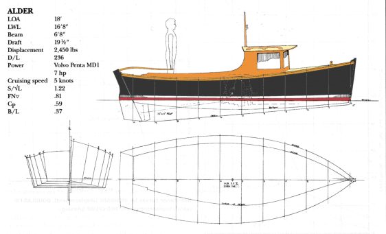

Spokaloo - I think Maia is too much for me right now; Boojum's more like a 30' boat squashed in to 22'; needs a semi-tractor to tow. I've admired the next one as you have, but as you said a complex build; that would be one I'd be very interested in in this building method. I also like his (26') outboard powered "river" boat, makes me think of your nina with basic accomodations. It too would benefit greatly from a Bateau method redesign. Finally Alder's cute, but in that size the HMD18 gives me a lot more boat for my money, a vee-hull, and a lot simpler and cheaper propulsion system.

I really think Alder holds tremendous promise. She can easily be turned into an outboard, with the same helmsman's position. One could even mount it in the well, then attach the motor to a wood tiller to preserve the look, if you were so inclined. Id definitely like to see it redrawn at 22 feet though, since 18 feet isn't going to offer much in the way of accomodations. Imagine it stretched a bit, with more cabin (though of the same height). Would be a very handsome craft, and extremely handy.
Look at the FL hull shape:
Id think Jacques could use the same ideas to give her more semi-displacement speeds than the 5kts offered by the original design. Having a boat like it, which can do 12-15 kts in advance of a squall sure would be convenient.
