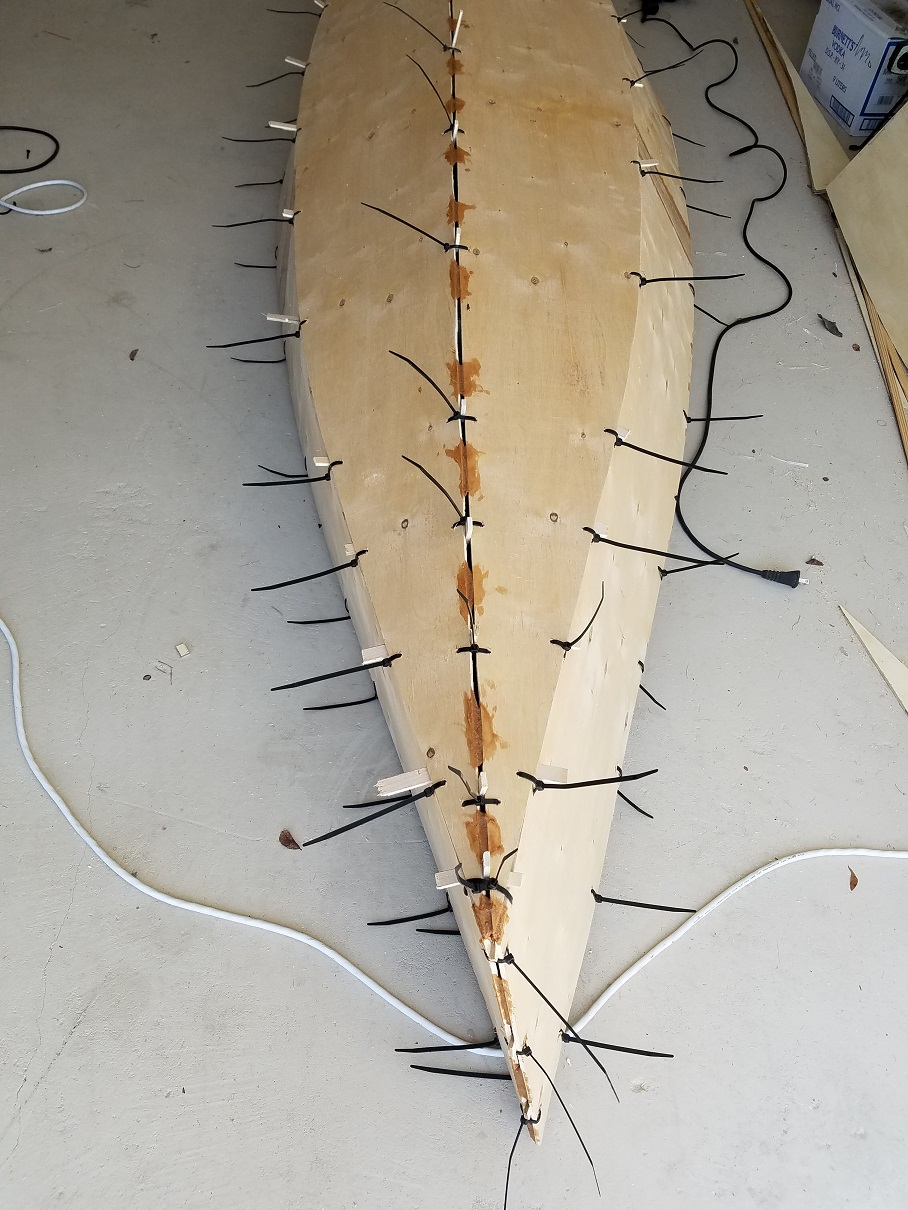

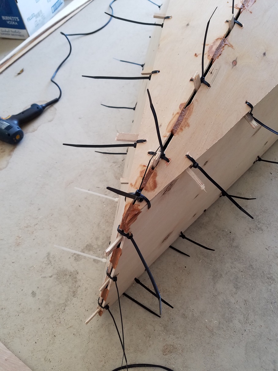

Manged to get some of the tacks completed at lunch.

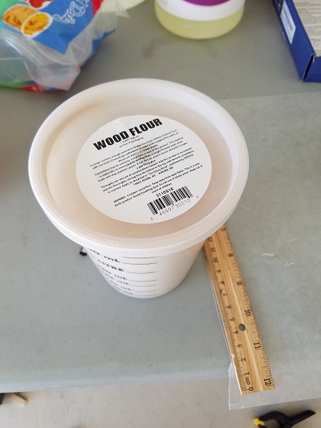

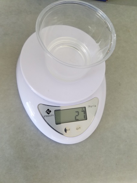

The wood flour.
Here is how I mixed the paste for tacking:
First some resin.
Then some hardener.
Then some wood flour. I made it kind of thick so it would run off.
And the tacks.

Looking good!
You are going to be surprised how solid just those tack welds will make it feel :)

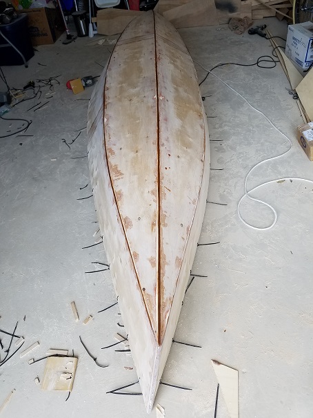

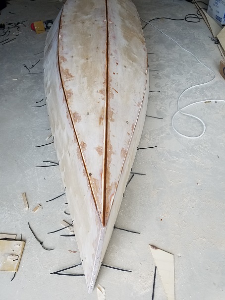

Post by snail » Thu Sep 21, 2017 6:01 pm

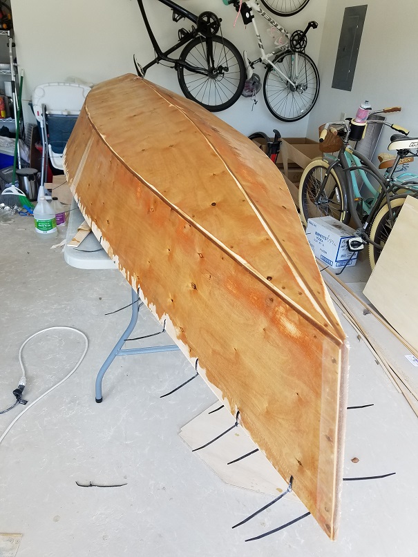

I got a little more work done on the Kayak. The three bottom seams are completely filled. I just need to sand them smooth and I'll be ready to glass the bottom. I have learned a few lessons so far. Making the seams really good before tacking will cause less work down the road. Also taping before glueing the seams makes far less work. My seams were pretty bad so it took a bunch of sanding and then some additional filling in to get them smooth.

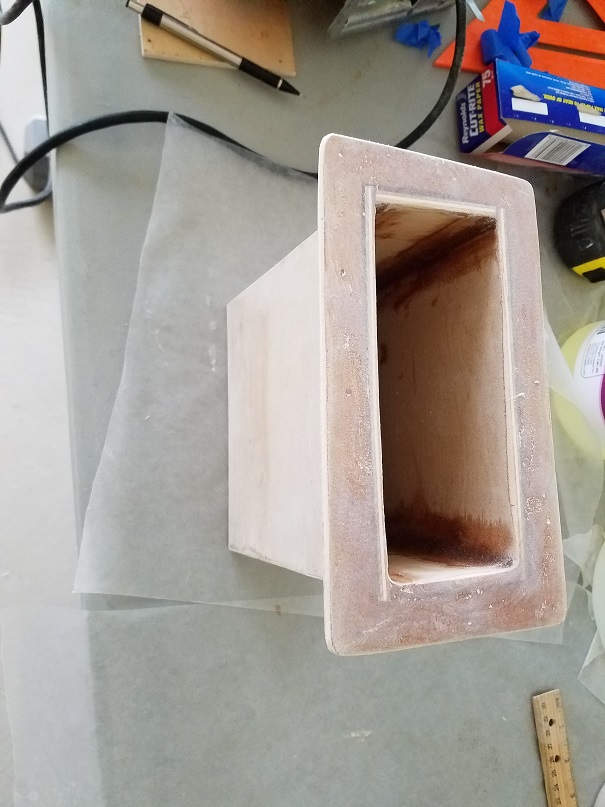

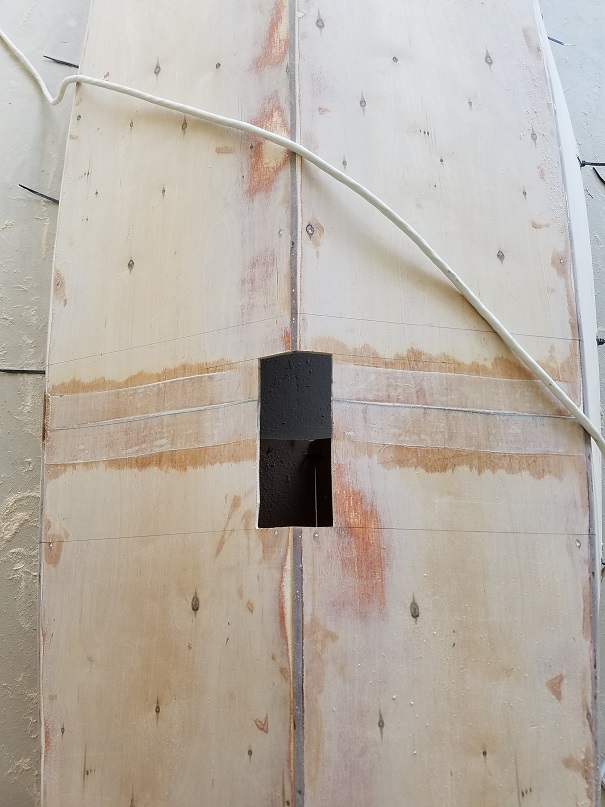

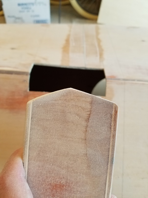

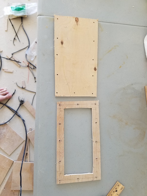

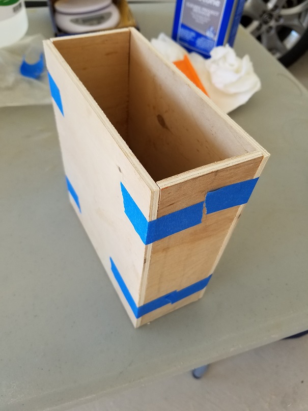

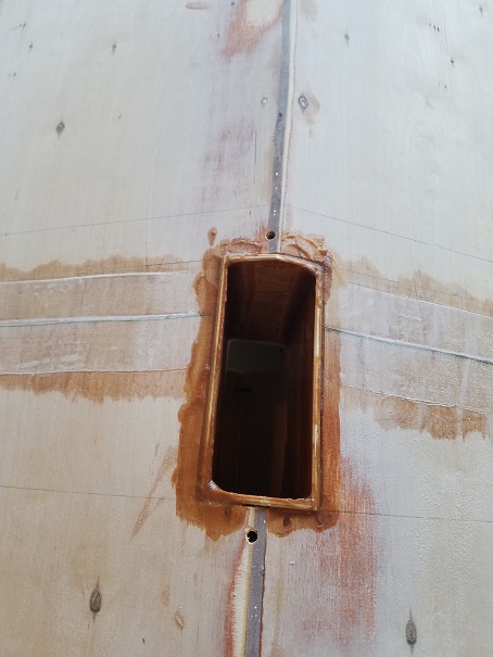

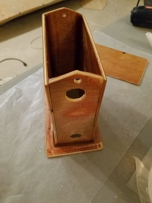

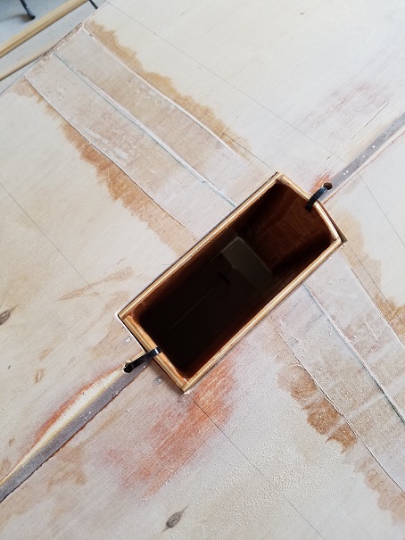

Decided to add a thru hull chamber for a depth finder transducer and to drain a scupper port that will be in the sole. This chamber will extend thru the bottom into the back chamber behind the seat wall. I fabricated a small box with holes for the transducer cable and the scupper drain. I also made a top for it. Cutting the hole through the bottom was hard to make myself do but I think it will be worth it in the end.

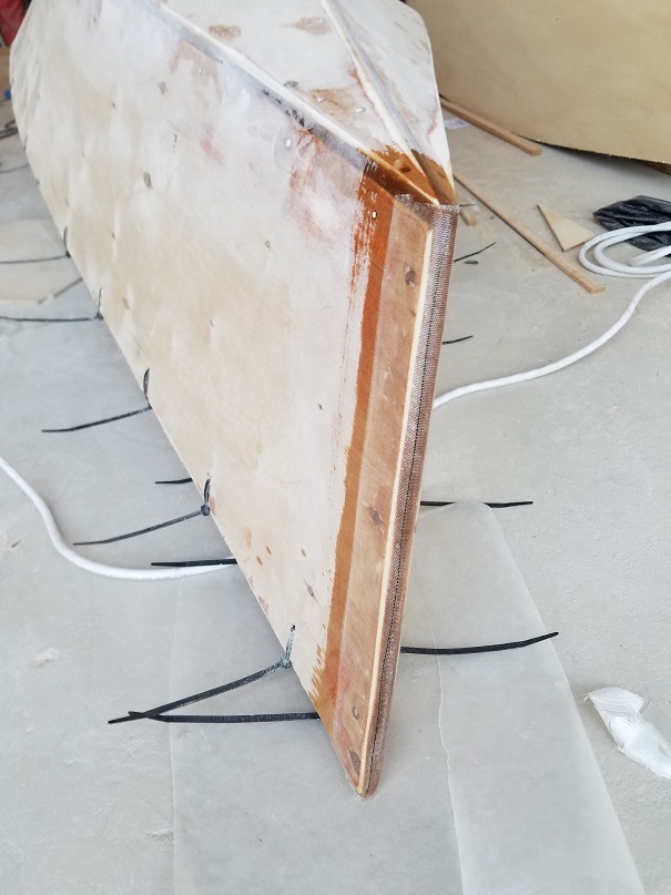

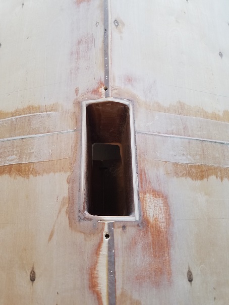

Managed to get the transducer box stitched, glued, and first round of sanding done. I filled in the holes and uneven spots and I'll come back and sand them when they dry. Also managed to get the bow and stern glassed.

Post by snail » Thu Oct 05, 2017 5:19 pm
Got the bottom and sides glassed.
