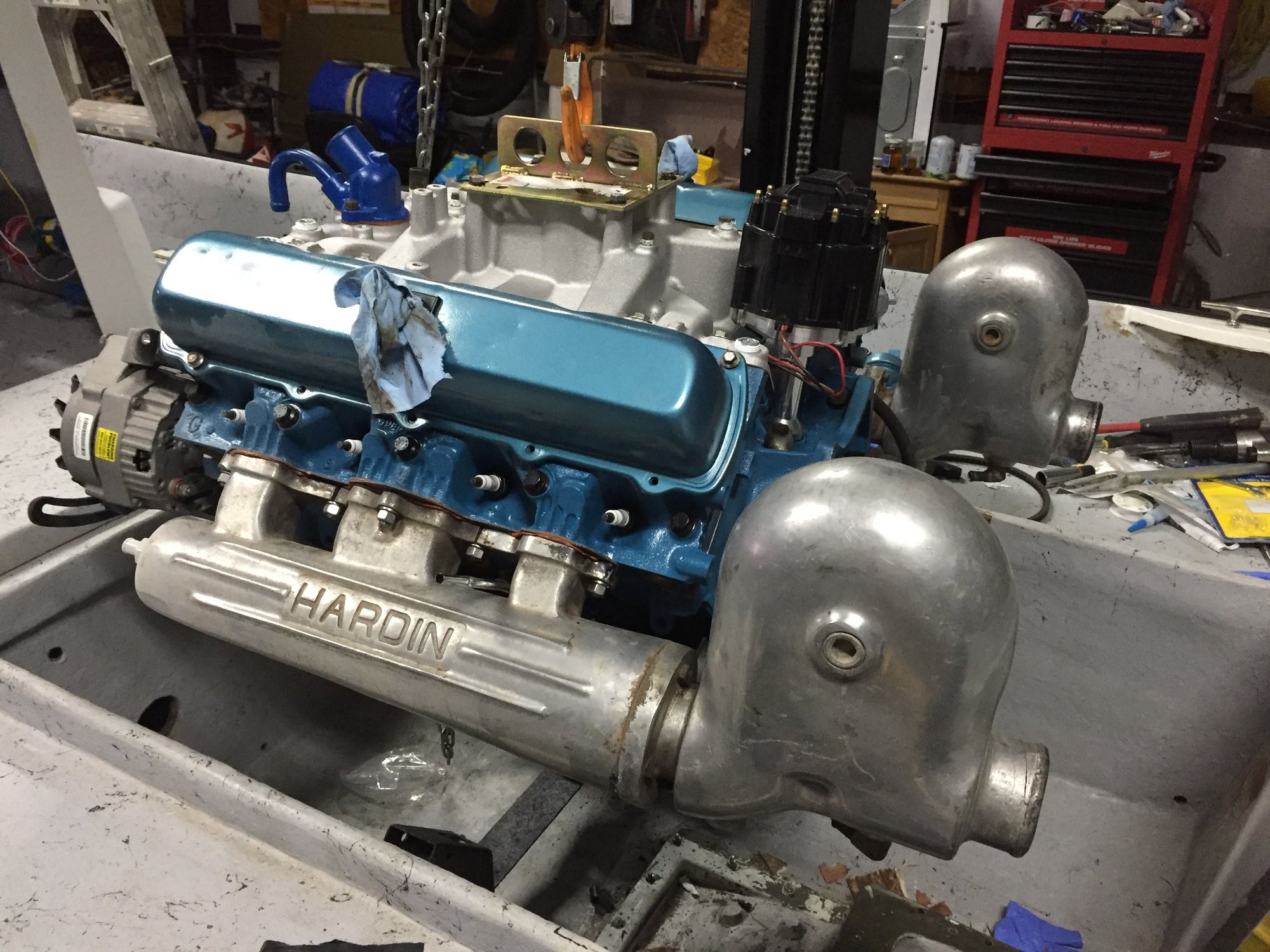

Can't believe it's been so long since last update in July. I lost my job in September and had to slow down on the boat. But I'm back with some progress. I have the engine assembled and in the boat. I'm going to be adding pulleys and alternator, the. Start to run wiring so I can run just the engine to break it in.
https://cimg3.ibsrv.net/gimg/www.thehul ... 065a8.jpeg
Still can't figure out. The picture thing

Luke, good to hear from you!! Sorry about the loss of job and I hope you have found something better!! Motor looks great. No issue on the photos, just send us more links!! Jeff

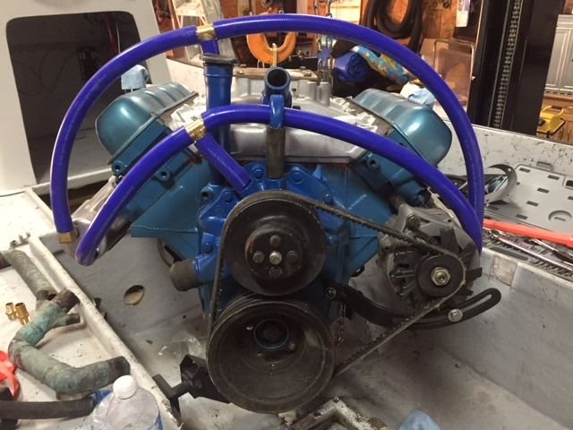

I did find a job, been hard at it for two months. Managed to get the exhaust on and front pulleys. It's slowly getting there. I have the heat exchanger in and will try to install it this weekend

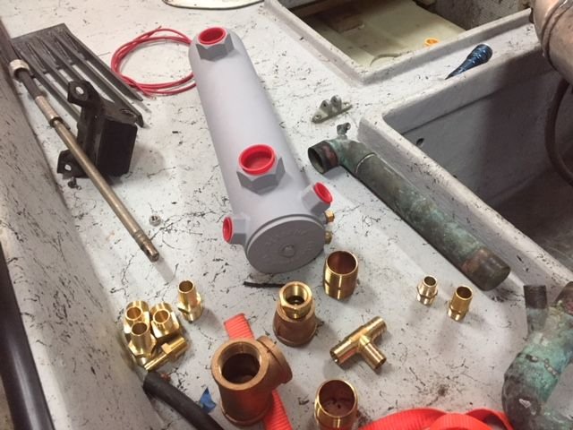

i mocked up the plumbing for the engine, and took a pic of the exchanger. Trying to get it done this weekend.

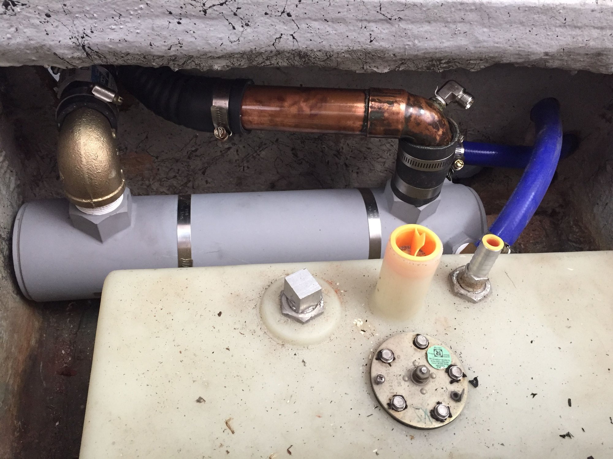

Small update. I got the closed loop cooling system finished, I cleaned up and reused my uncles brass piping and clear coated it. Kinda looks patina, but not many will see it. Got it all plumbed up and the reservoir mounted with overflow tubing. Next I'll move on to fuel system. I have a mechanical fuel pump, but now I'm reading that it needs to be marine compliant, which has an extra port in case the diaphragm ruptures it will send gas to rear of carb instead of all over the bilge.
