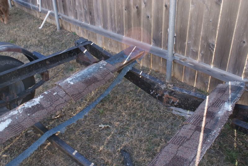

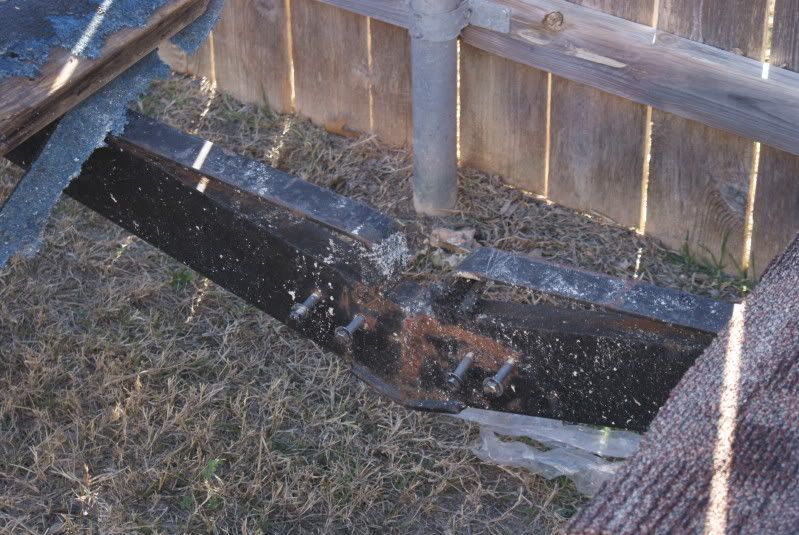

Trailer needs a full rebuil. Anyone know what the bolts on the rearmost crossbar are for?
I cant figure what they might be for. :doh:

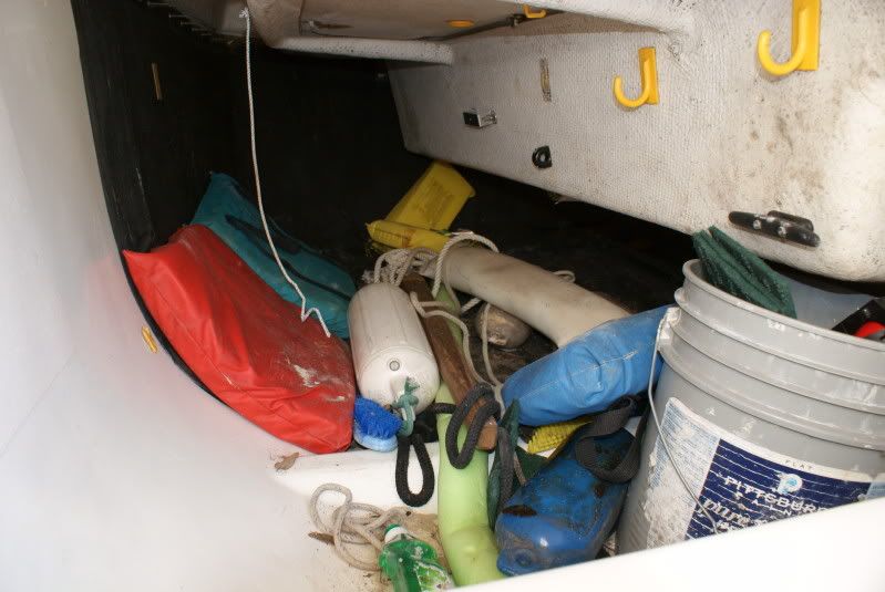

Almost looks like someone was living in it with as much junk was stored in it.
This is after I already pulled most of the junk out.

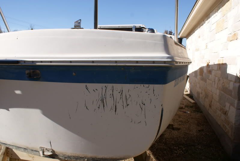

The damage on the transom (was told that it was from boat bouncing in a storm at the dock) is scratches thru the gelcoat barely nicking the glass. I alrady sanded down to good glass.
This is the scratches on transom.
After sanding
Can i fill with quickfair, or should I use thickened epoxy??

Quick Fair would be fine for that. The boat looks to be in pretty good shape. The bolts on the rear cross member probably held on center marker lights. Trailers over a certain size are required to have them.

The crossmember bolts are 4x 1/2". Might be overkill for a marker light.

Maybe there was a center roller there at one time. There ain't no telling, cut 'em off. You won't be using them anyway :D Thanks for the comments.

I have a couple spots around tight bends where the glass didnt fill all the way to the gelcoat (voids), after sanding these down can I also fill with quickfair? These i had to grind down about an 1/8" into the glass.

You'll need to show us a picture of those, but no, if you get into the glass you probably need to use a structural filler. If it's large you may need to lay some glass cloth in there. The glass is structural, never replace it with fairing compound. Post some pics of all the problem areas.
